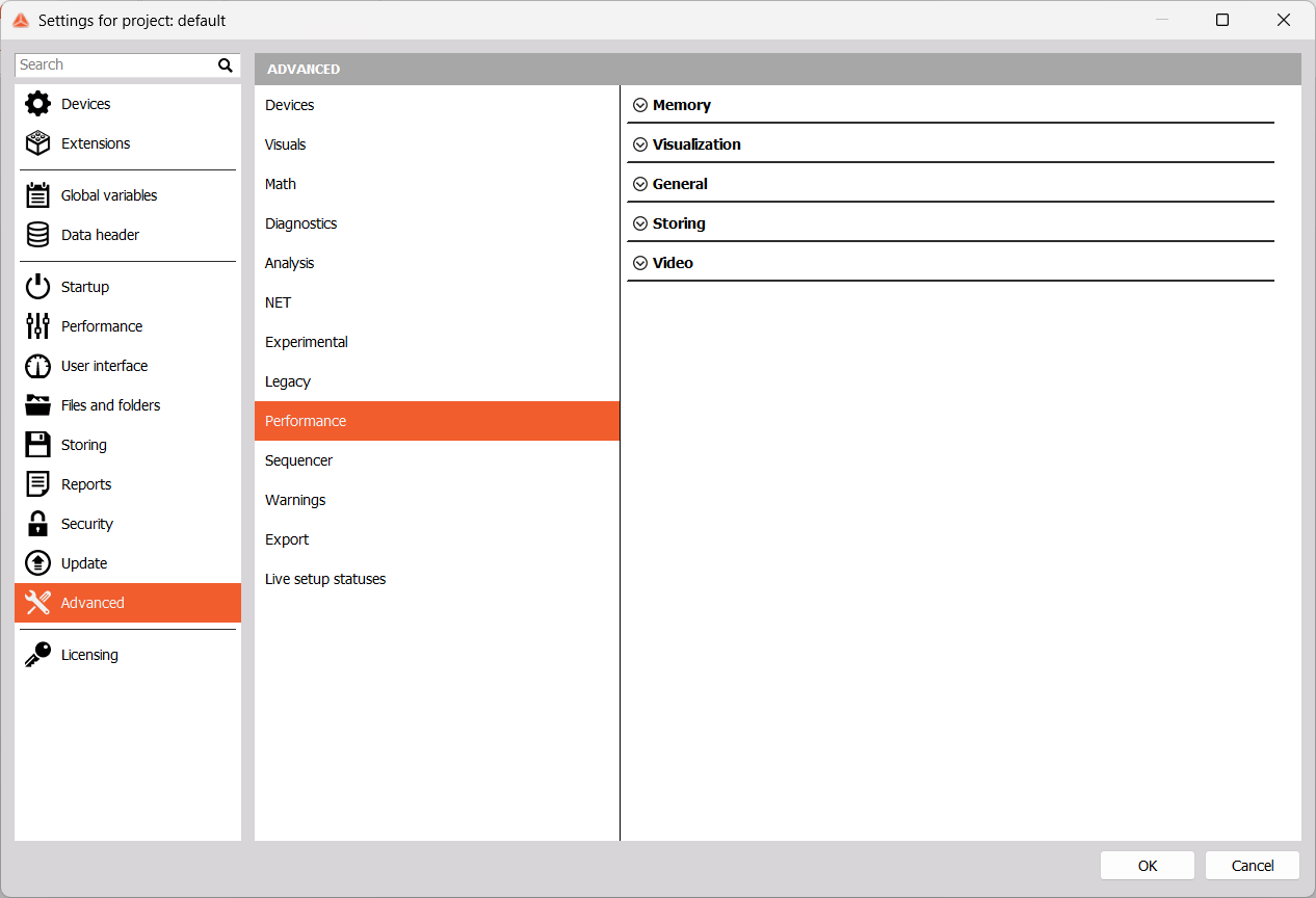

Performance
Memory
  • Memory manager
    • optimize for memory usage
    • optimize for performance
  • Allow acquisition loop to freeze displays when 100% occupied - If the setup is very complex, it needs more CPU. This option allows Dewesoft to freeze the graphics to save the CPU power for the calculations.
Visualization
General
Maximum calculation delay - By default Dewesoft allows 200ms of calculation delay. If the asynchronous channels are up-sampled during measurement, the interpolation works only for the last 200ms.
DS_options_settings_advanced_performance_calculationDelay
Storing
Video
