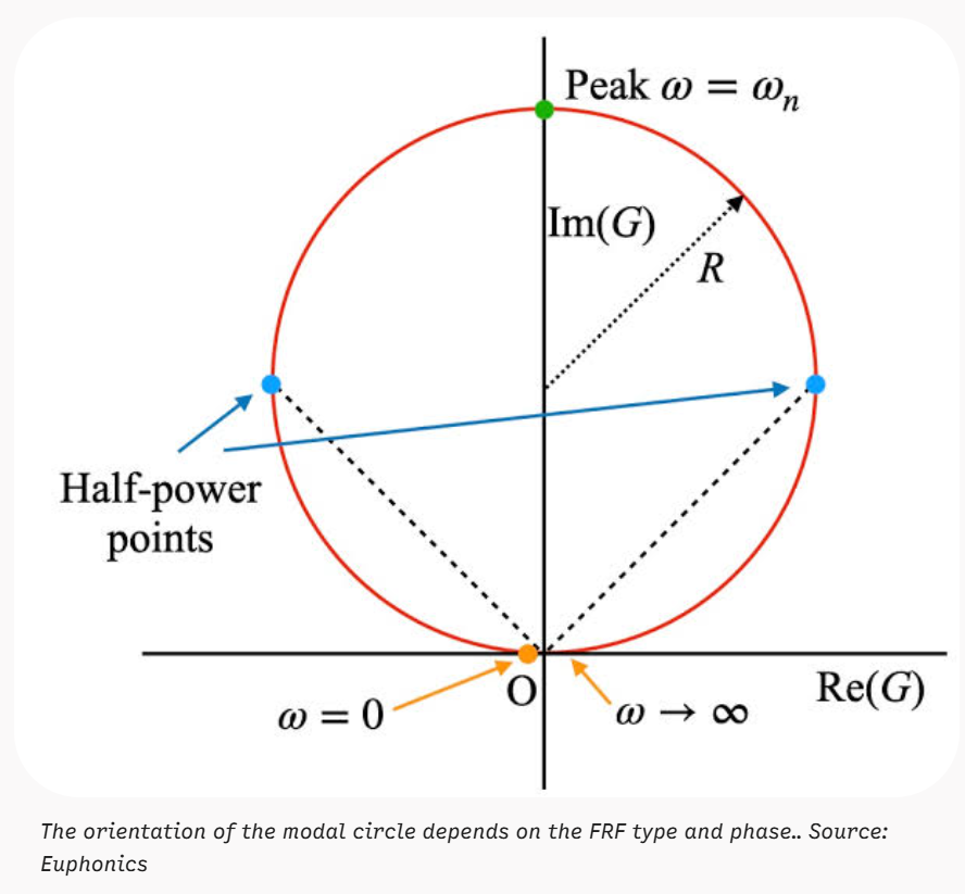

FRF sample points laying around a resonance will be positioned in a circular pattern when seen on a Nyquist plot, which has a real and an imaginary axis. The Modal Circle widget shows such a Nyquist plot together with a circle fitted to those Fit points. The circular shape of points arises due to the phase changes that happen around resonances.

To determine a resonance frequency $f_r$, first a circle is fitted to N number of FRF Fit points around an FRF resonance peak. Next, $f_r$ is determined by the fitted Circle center, the Complex plane origin position, and the two Fit points closest to the resonance frequency, one below $B$ and one above $A$ with respect to frequency:
From the picture above, the determined Resonance frequency $f_r$ is marked with a red circle point. $f_r$ is found on the fitted blue circle at the position where the green line crosses over. The green line is a line going through the Complex plane origin and the fitted circle center.
Described with a formula this can be written as:
$$f_r= \frac{\theta_A \cdot f_B - \theta_B \cdot f_A}{\theta_A - \theta_B},$$
where points $A$ and $B$ are the points just After and just Before the resonance frequency. $f_A$ and $f_B$ are the frequencies of those points, and $\theta_A$ and $\theta_B$ are angles between the green line to $f_r$ and the orange lines from the Circle center to point $B$ and $A$.
