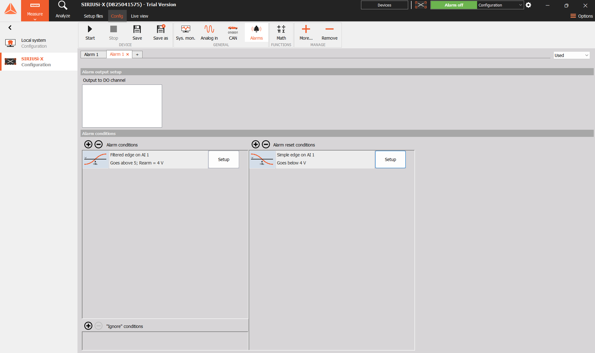

1. Configure an alarm
Select the device in DewesoftX, then open Config → Alarms. If Alarms is not visible, open More… and choose Alarms under General. This adds the module and opens its first alarm instance.
Each alarm has its own tab, such as Alarm 1. Select + beside the tabs to add another instance. Use the Used / Unused selector to enable or disable the selected instance.

Each alarm has three condition lists:
Condition list Purpose
Alarm conditions Start conditions that raise the alarm.
Alarm reset conditions Stop conditions that return the alarm to Idle.
“Ignore” conditions Suppress start triggers in the configured signal or time region.
Configure the start condition and the way the alarm should clear before using its output. An alarm returns to Idle when a stop condition fires or it is manually reset. Returning the input below a start threshold clears the alarm only when a suitable stop condition has been configured.

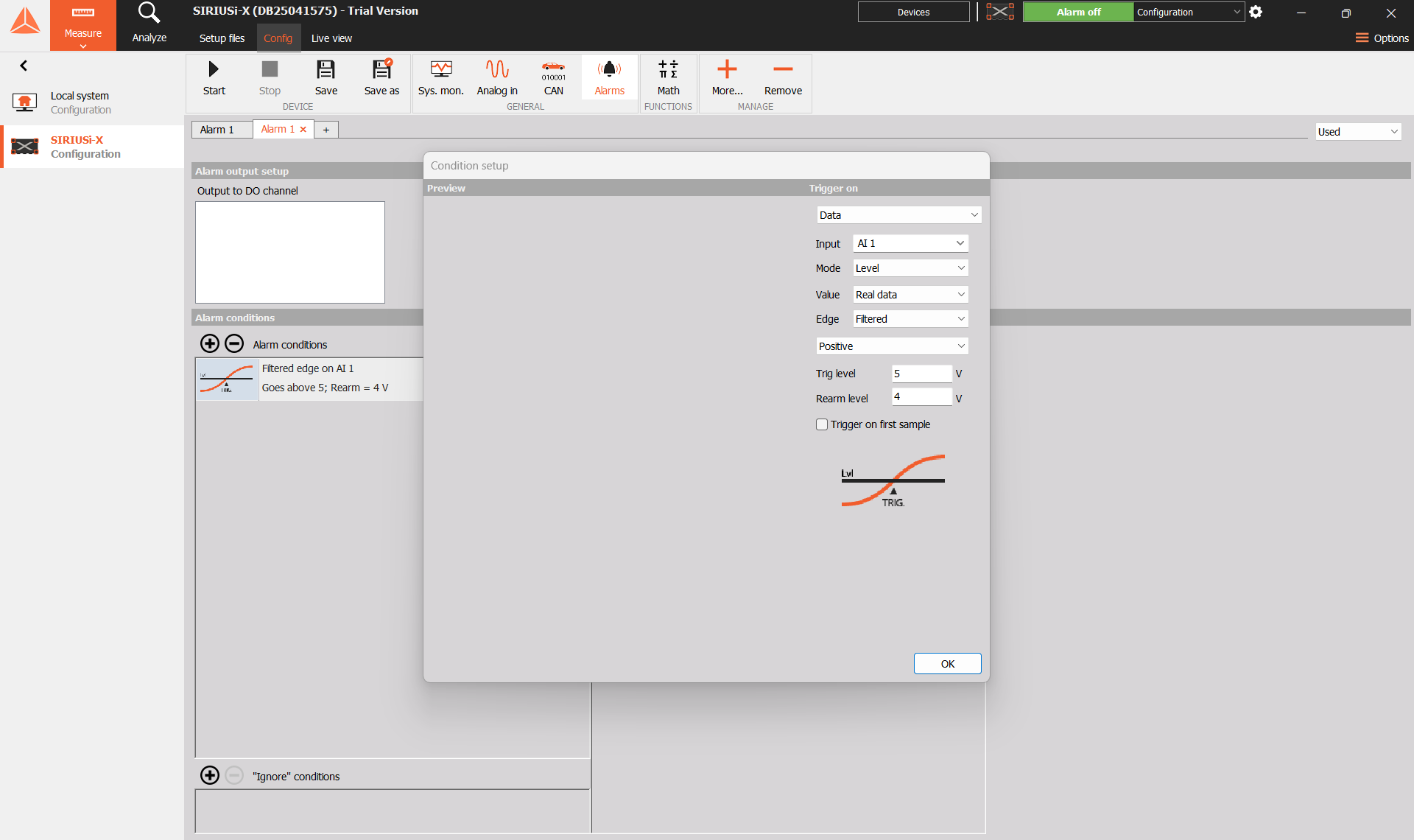

3. Set a level condition
Set Trig type to Data and Mode to Level. Select the Input, choose the Value to evaluate, then set the direction and Trig level.
Setting Purpose
Input Signal evaluated by this condition.
Value Real data, Average, RMS, Min, or Max. Real data evaluates direct samples.
Interval Aggregation interval when evaluating a statistic.
Trig level Threshold in the input signal’s units.
Positive direction Fires when the value crosses the threshold upwards.
Negative direction Fires when the value crosses the threshold downwards.
Trigger on first sample Allows the condition to fire immediately on the first sample.
Direct samples evaluate the acquired values. Average, RMS, Min, and Max evaluate a statistic over the configured interval. Choose the statistic to match the quantity being monitored: an RMS threshold and a direct-sample threshold can respond differently to the same waveform.
By default, Trigger on first sample is disabled. Consider enabling it when an alarm must detect a signal that already satisfies the condition when evaluation begins. Check this behavior with the intended input before deployment.
Set rearming
Level start and stop conditions support hysteresis-based rearming. Set Edge to Filtered to show Rearm level. Enter the level the signal must cross before the condition can fire again. Use Simple for a threshold edge without this rearm filter.
Condition setup showing a filtered positive edge on AI 1
Rearming controls when an individual condition can fire again. Configure a stop condition as well when the alarm must clear automatically.
4. Raise and clear an alarm at different levels
For an input measured in volts, use the following example to raise the alarm above 5 V and clear it when the signal falls below 4 V:
Condition list Input Type Direction Level
Start AI 1 Level, direct samples Positive 5 V
Stop AI 1 Level, direct samples Negative 4 V
Starting with the signal below 4 V, raise it through 5 V. The alarm becomes Active. Lower it to 4.5 V; it remains Active. Lower it through 4 V; the stop condition returns it to Idle.
The gap between the start and stop levels prevents the alarm from repeatedly changing state around a single threshold. Choose levels that suit the measured quantity and its expected noise.

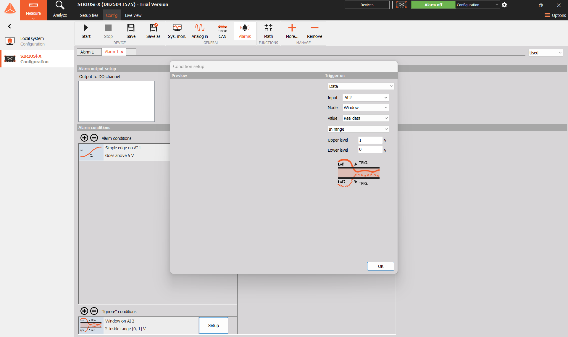

5. Use a window condition
Set the lower and upper bounds of the range, then choose whether entering or leaving that range should fire the start or stop condition.
Choice Behavior
Enter range Fires when the signal enters the configured range.
Leaves range Fires when the signal leaves the configured range.
In range, for ignore conditions Suppresses start triggers while the signal is inside the range.
Out of range, for ignore conditions Suppresses start triggers while the signal is outside the range.
Use a leaving-window start condition when a signal must stay within an acceptable range. Add a suitable stop condition when returning to that range should clear the alarm.
Window conditions can evaluate direct samples or interval statistics. Check both bounds and the selected statistic before using the condition.

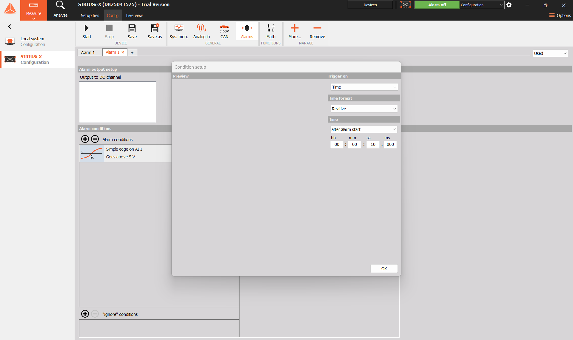

Enter relative time in the hh, mm, ss, and ms fields. For an alarm reset condition, Relative also provides after alarm start, which times the reset from the start condition.
For example, select after alarm start and enter 00:00:10.000 to clear the alarm 10 seconds after its start condition fires.
Time condition configured to reset the alarm after ten seconds

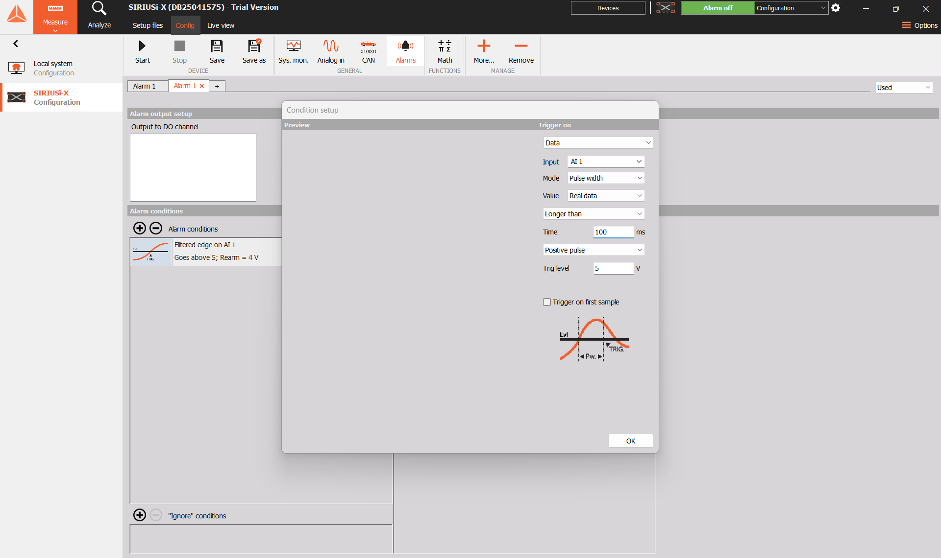

7. Use a pulse-width condition
Set Trig type to Data and Mode to Pulse width. Choose the Input, Trig level, and Positive pulse or Negative pulse direction. Select Longer than or Shorter than and enter Time in milliseconds.
The checked device exposes the following settings for pulse-width start conditions:
Setting Choices or purpose
Direction Positive pulse or Negative pulse.
Level Threshold used to identify the pulse.
Duration comparison Longer than or Shorter than.
Time Non-negative pulse duration. DewesoftX displays milliseconds.
Trigger on first sample Controls evaluation at the first sample.
Use a controlled signal to check the response to pulses shorter and longer than the chosen duration. Include pulses that begin before evaluation starts when first-sample behavior matters.
Pulse-width condition on AI 1 with a 100 millisecond duration
8. Suppress unwanted starts
Use ignore conditions for signal regions or time periods in which start triggers should be suppressed. For example, an ignore condition can suppress starts while an enable signal is below a chosen level.
Ignore condition Suppressed region
Level Above or below the configured level.
Window Inside or outside the configured range.
Time Before or after the configured time.
Ignore condition with a window on AI 2
Figure 5. Starts are suppressed while AI 2 is in the range from 0 V to 1 V.
Ignore conditions suppress start triggers. Use stop conditions or a manual reset to clear an alarm that is already Active.
