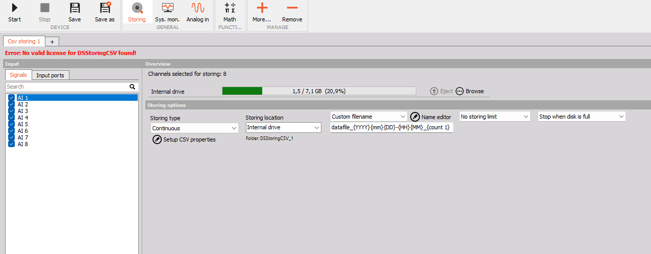

CSV storing requires a valid DSStoringCSV license. Without it, the storing tab shows the message Error: No valid license for DSStoringCSV found!
1. Open the storing configuration
Select the device in DewesoftX and click Storing in the General group of the device toolbar. Each storing instance has its own tab, such as Csv storing 1.
The page shows the available signals and input ports, the number of channels selected for storing, the storage usage and the storing options.

2. Select signals
In the Signals tab, select the signals you want to store. You can select acquisition channels and the outputs of on-device processing. Use Search to filter the list. The Overview shows the number of selected signals under Channels selected for storing.
The example selects AI 1 to AI 8.

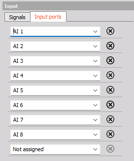

Assign input ports
The Input ports tab shows which signal is assigned to each input port of the CSV recording.
  • To assign a signal to a port, select it from the drop-down list.
  • To remove a port, click the remove button (⊗) next to it.
  • To add a port, select a signal in the last row, marked Not assigned.
Input ports tab with AI 1 to AI 8 assigned

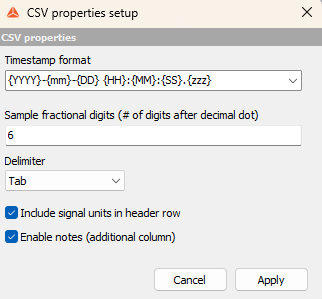

4. Set the CSV properties
The CSV properties define how the values are written to the file.
  1. Click Setup CSV properties below Storing type.
  2. In the CSV properties setup window, set the options.
  3. Click Apply.
UI setting Purpose
Timestamp format Format of the timestamp written in each row. The default is {YYYY}-{mm}-{DD} {HH}:{MM}:{SS}.{zzz}.
Sample fractional digits (# of digits after decimal dot) Number of digits written after the decimal point of each sample value. The default is 6.
Delimiter Character that separates the values in a row. The default is Tab.
Include signal units in header row Adds the unit of each signal to the header row.
Enable notes (additional column) Adds a column for notes to the file.
The timestamp tokens follow the filename tokens described in Set filenames. {zzz} is the millisecond part of the timestamp.

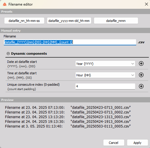

6. Set filenames
Choose Custom filename or Copy Dewesoft X filename. For a custom name, type the template directly in the filename field or click Name editor.
The Filename editor contains:
  • Presets: ready-made templates datafile_nn_hh-mm-ss, datafile_yyyy-mm-dd_hh-mm and datafile_nnnn.
  • Manual entry: the filename template. The .csv extension is added automatically.
  • Dynamic components: select a date component, a time component or the unique consecutive index and click ⊕ to insert it into the template.
  • Preview: example filenames for several start times.
Click Apply to use the template.
Filename editor with date, time and counter placeholders
Token Meaning
{YYYY} Four-digit year
{mm} Two-digit month
{DD} Two-digit day
{HH} Hour, in 24-hour format
{MM} Minute
{SS} Second
{count N} Counter starting at N, padded to four digits by default
{count N P} Counter starting at N, padded to P digits
Tokens are case sensitive. {mm} is the month and {MM} is the minute.
The default template is datafile_{YYYY}{mm}{DD}-{HH}{MM}_{count 1}. For example, a file started on 23 April 2025 at 07:13 with counter 1 is named datafile_20250423-0713_0001.csv. The next file gets the counter 0002.

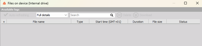

9. Browse and retrieve recordings
Click Browse beside a storage medium to open Files on device.
Files on device window for the internal drive
The list shows the File name, Type, Start time (in the device time zone), Duration, File size and Status of each recording. You can search for files or switch between the Full details, Quick list and Drive root views. Select Auto-refreshing to update the list automatically.
Select files to Download or Delete them. Download recordings to the PC to work with them, and delete device files you no longer need.
Open downloaded .csv files in a spreadsheet program, a text editor or your own analysis scripts.
