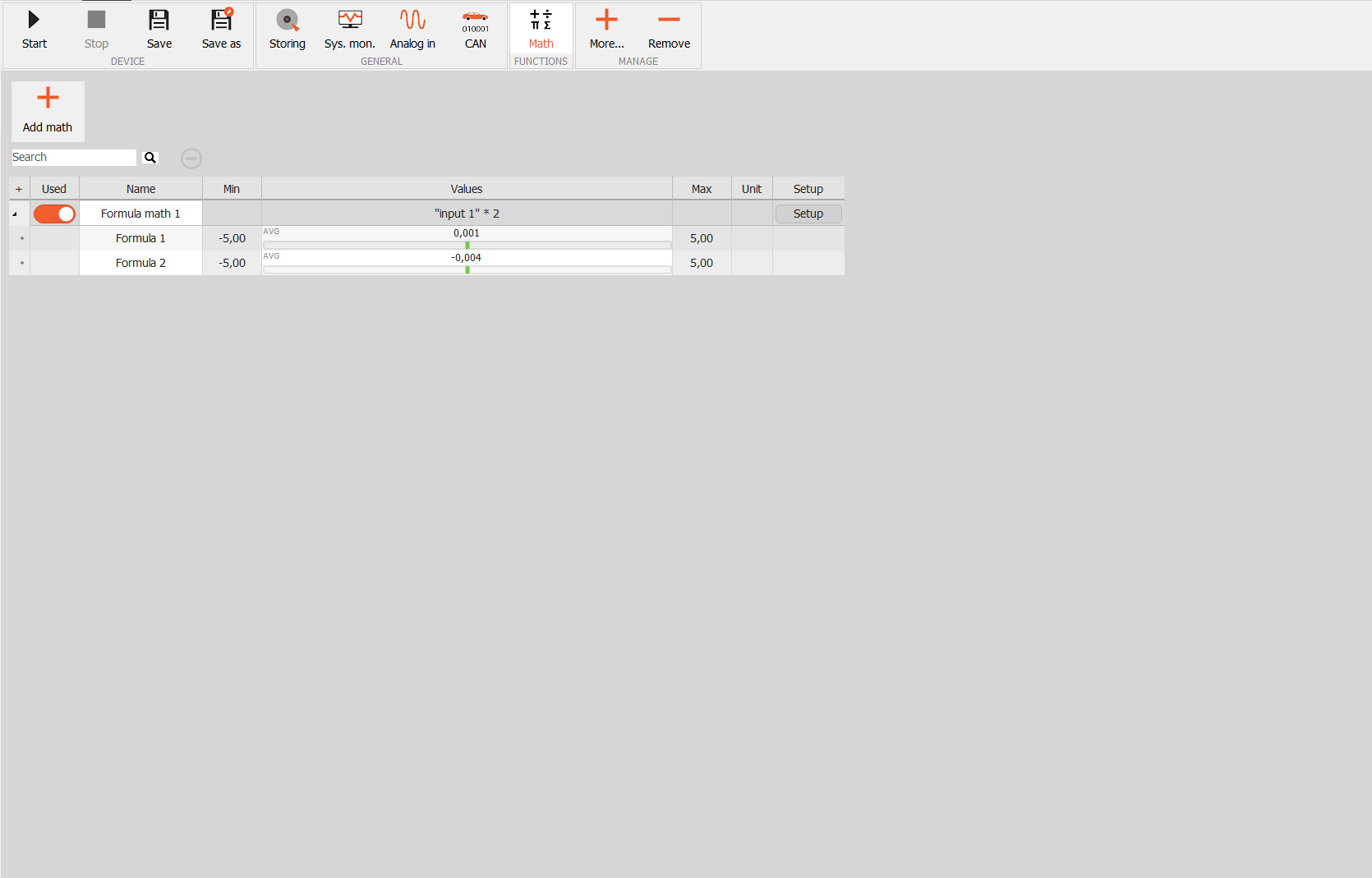

1. Open the Formula configuration
Select the device in DewesoftX, then open Config → Math. Select Add math, then choose Formula under Formula and scripting. To edit an existing block, select Setup in its row.
The Math overview shows the shared expression and the outputs below it. Use the Used switch to enable or disable the block.

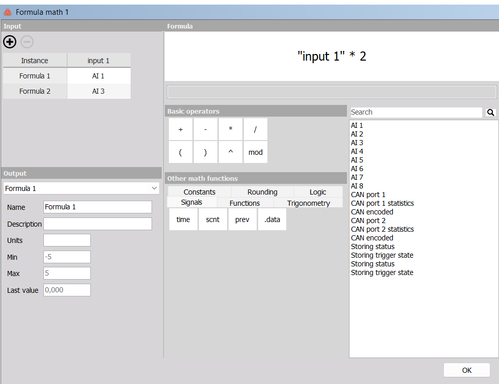

3. Assign input signals
In the Input table, select the cell below the required variable name and choose a signal from the selector. Repeat this for every input column in the row. A cell showing
For "input 1" * 2, assign AI 1 to input 1 in the first row. The output Formula 1 then contains twice the value of AI 1.
For a calculation with two inputs, enter an expression such as:
"input 1" + "input 2"
Assign AI 1 to input 1 and AI 2 to input 2 in the same row. The output contains the sum of the two signals.

4. Apply the formula to several signal groups
Select + above the Input table to add an instance. Each row has its own signal assignments and produces one output. All rows use the expression shown in the Formula editor.
For the expression "input 1" * 2, the following assignments create two independent outputs:
| Instance | input 1 | Calculation |
| Formula 1 | AI 1 | AI 1 multiplied by 2 |
| Formula 2 | AI 3 | AI 3 multiplied by 2 |
Select a row and use − to remove that instance. Check which row is selected before removing it.
Changing the expression changes the calculation for every instance in the block. To use a different expression for another signal group, add a separate Formula block from the Math overview.
5. Check the output
Use the Output selector to choose the calculated signal to inspect. Here you can change its Name and Description, and view its available metadata and last value.
The tested version shows Units, Min, and Max as read-only fields. Use the enabled fields in your version and check the displayed metadata before using the output in a display or recording.
Select OK to close the editor and return to the Math overview. Expand the Formula block to see its output rows and values.

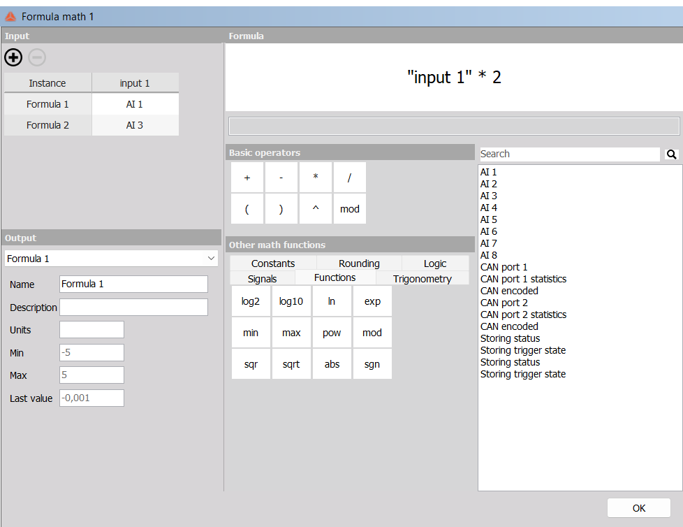

6. Use operators and functions
The editor provides Basic operators and tabs under Other math functions. Hover over an operator or function to see its syntax and description. The signal list has a search field for finding available channels.

Mathematical functions
| Functions | Calculation |
abs(x) |
Absolute value |
sqr(x), sqrt(x) |
Square and square root |
sgn(x) |
Returns −1, 0, or 1 according to the sign of x |
min(x, y), max(x, y) |
Minimum and maximum |
exp(x) |
Exponential, e to the power x |
ln(x), log2(x), log10(x) |
Natural, base-2, and base-10 logarithms |
sin(x), cos(x), tan(x) |
Trigonometric functions with angles in radians |
trunc(x) |
Truncates toward zero |
round(x) |
Rounds to the nearest integer |
floor(x), ceil(x) |
Rounds down and up |
sqrt(x) returns zero for negative inputs. The logarithm functions return zero for inputs less than or equal to zero. The constants pi and e are available without quotes.
