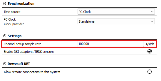

A lot of SENT sensors have short pulse periods so they need to be sampled at higher sample rates to be decoded correctly. We recommend sample rates of at least 100KHz or more. This includes also channel setup sample rate in order for SENT to decode channels correctly while in cannel setup.
NOTE: Channel setup sample rate should be set to at least 100kHz in order to decode messages correctly while in channel setup!
If channel setup sample rate is not set you can change it under settings.
