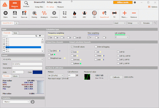

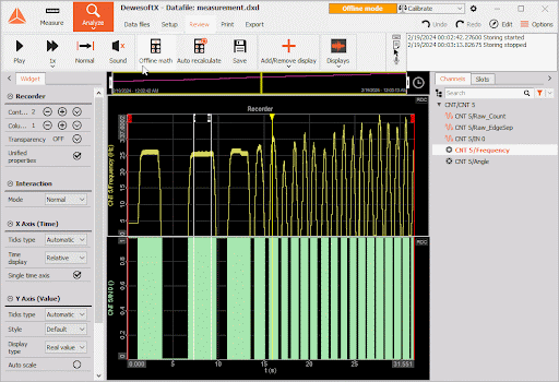

  • Calibration - Offers (simultaneous) calibration functionality for Power, TV, CEA, HBV, SLM, Counters, OA, Angle sensor math, Microphone correction, and Resolver sensor math. To perform calibration, we simply select the math modules we would like to calibrate, then press the Calibrate button. Upon completion, the menu will contain statuses and calibration parameters. By pressing the Revert button, we can revert the calibration. Calibration can also be performed in Analysis mode on pre recorded data files. To do so, we open a data file, zoom in on the valid part of the signal, and recalibrate the math by pressing the Calibrate button. To apply the recalibration to the rest of the data file, we press the Recalculate button. The recalibrated parameters can be exported to a .dcf file and imported into different data files with the Import and Export buttons.
