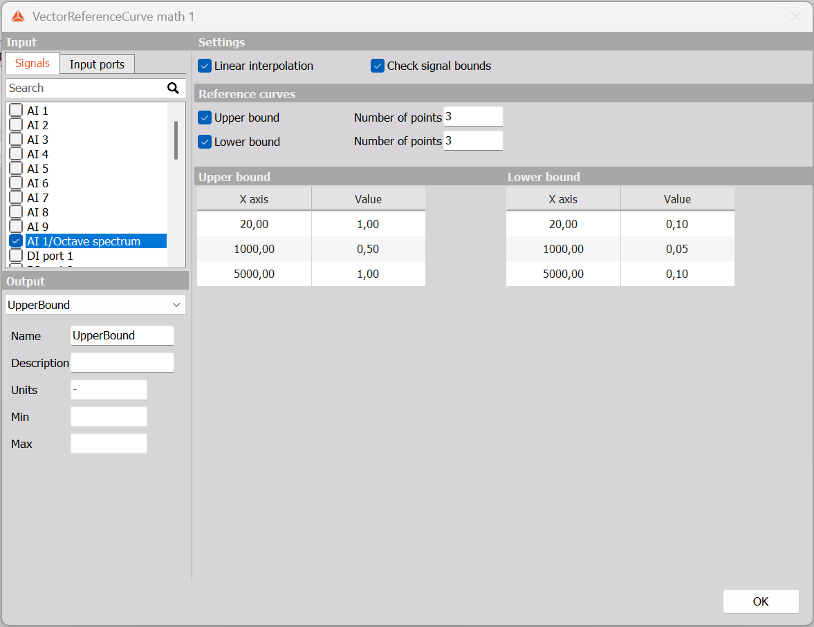

On-device Vector reference curve with upper and lower bounds, three points per curve, linear interpolation, and signal-bound checking

The screenshot uses the octave spectrum as input, enables both bounds, and defines three points for each curve:
X axis (Hz) Upper bound value Lower bound value
20 1 0.1
1000 0.5 0.05
5000 1 0.1
Linear interpolation and Check signal bounds are enabled. These values illustrate the setup procedure; choose reference levels and X coordinates for your own signal and acceptance criteria.
Select OK to return to the Math overview. The generated reference curves can be displayed with the input vector in a 2D graph. The status channels are separate scalar outputs for evaluating the configured bounds.
