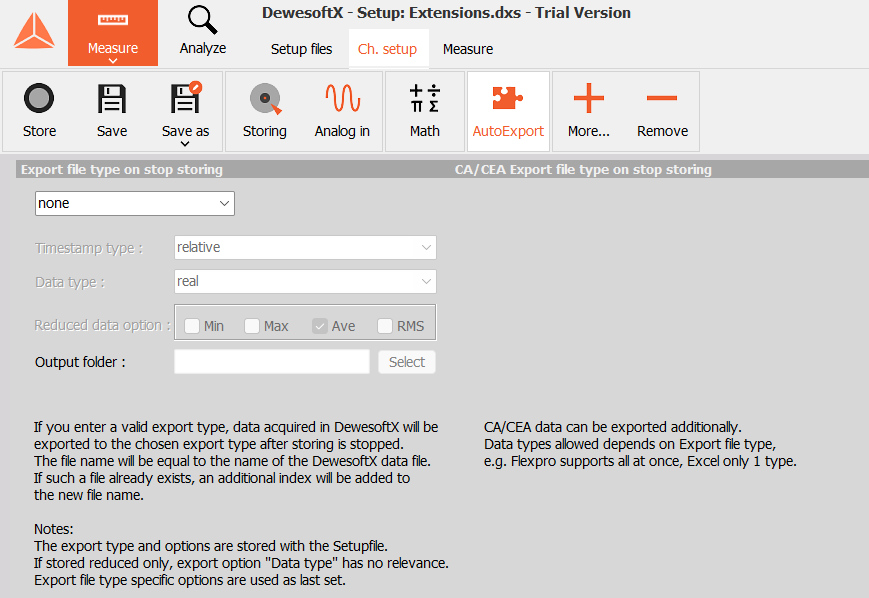

Auto Export
The Auto export extension will automatically export the data acquired in DewesoftX to the choosen export file type when storing is stopped. The file name of the exported file will be the same as the name of the DewesoftX data file. If such file already exists, an additional index will be added to the new file name.
Export File Type
You can choose which file type the data will be exported to from the dropdown list. Besides predefined options, you can also choose a custom export type.
NOTE: **The Universal file format 58 requires the UNV addon in order to work properly despite being shown as default export type. This problem will be fixed soon. **
