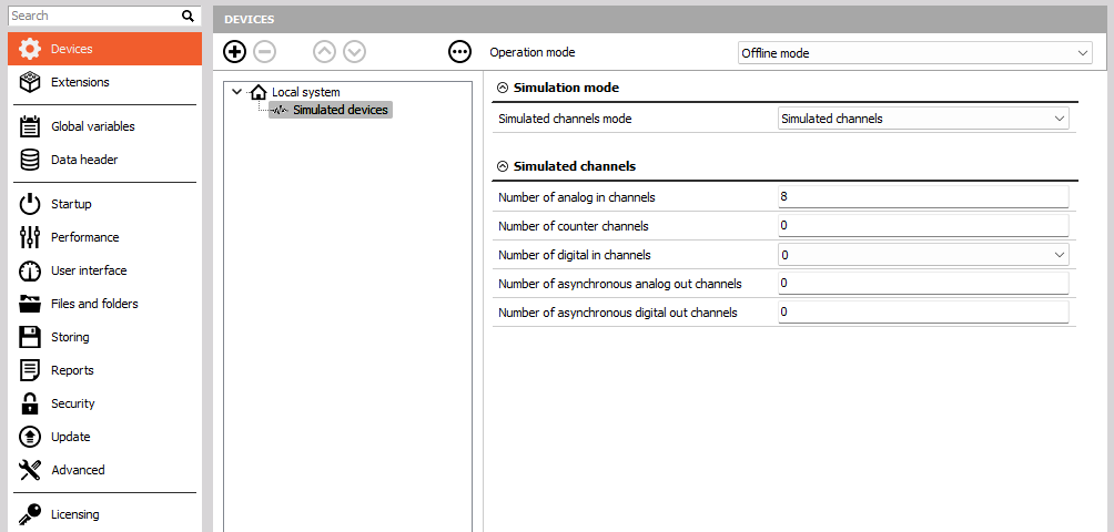

Choose Offline mode and customize it in Options - Settings - Devices - Simulated devices:
DS_options_settings_simulationMode_modeType
  • Simulated channels - Define the number of analog in, counter, digital in, asynchronous analog out, and asynchronous digital out channels.
DS_options_settings_simulationMode_simulatedChannels
